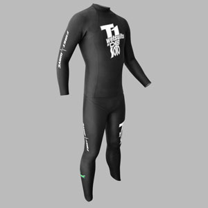

Here's food for thought. ROKA chiefly, but not exclusively, talks about flotation via the strategic placement of panels in the suit to generate a float profile. If you look at ROKA's Maverick suits you'll see that strip of 5mm high-float panel down the front, with panels offering lesser float to each side. There a nice big pic of the Aquaman ART showing a similar motif. The T1 bibjohn is 5mm from the hips down. From the hips up it's 3mm throughout. The pullover is 2mm throughout, and the idea is for that 2mm + 3mm overlap to give you float in specific areas. HUUB likewise uses a strategy designed to nuance the float in the chest area, accentuating the float in the hips down to at least the knees. This is a strong theme in these wetsuits. Make of this what you will.
So, what about the Concept 5? This is De Soto's pullover that has 5mm arms. De Soto figured out pretty early on what it took a lot of other wetsuit companies a lot longer to figure out: with the advent of the softer rubber than really has been around going back 15 and more years, using rubber 1.5mm thick in the arms is not an imperative. We introduced 1.5mm arms at QR back in the early 90s because our rubber wasn't flexible enough. Now, 2mm rubber is fine. So, since we can use 2mm, even 3mm, because the rubber is so soft, is the suit any faster if you stick a bunch of float in the arms? I think it depends on the swimmer. Good swimmers, less so. Bad swimmers, more so. If your hand immediately begins to sink upon water entry, after the catch, even 1.5mm arms will help float your arms and make you swim properly. But if you continue to resist every effort your wetsuit makes to get you to swim with your entire arm and hand near the surface of the water just prior to your "early vertical forearm" pull, then the 5mm rubber is not going to let you swim with your typically bad form.
